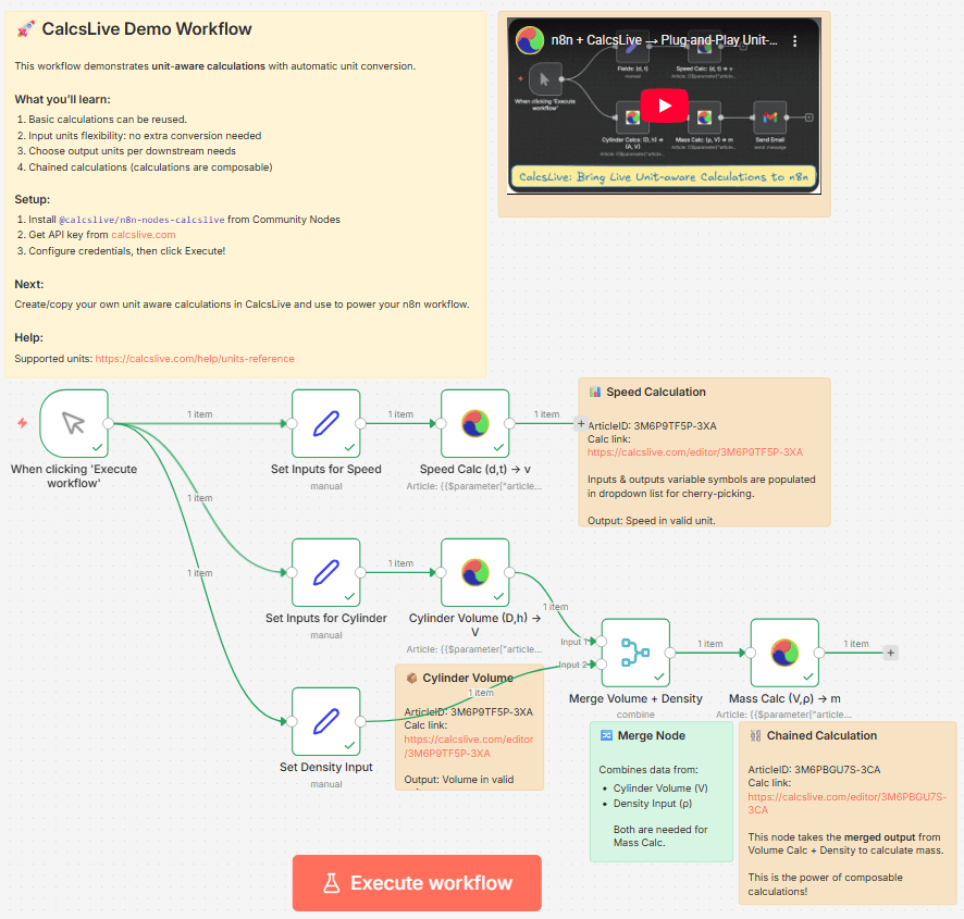

This template demonstrates how to perform unit-aware calculations with automatic unit conversion using the CalcsLive community node. It shows three calculation patterns:
  1. Speed calculation: Convert distance and time into velocity (km → km/h)
  2. Cylinder volume: Calculate volume from diameter and height (cm → Liters)
  3. Chained calculations: Pass output from one calculation as input to another (Volume → Mass)
Workflow Screenshot
CalcsLive Articles Used
You can view and customize each calculation article in the CalcsLive editor:
Calculation Article ID Link
Speed Calc 3M6P9TF5P-3XA Open in Editor
Cylinder Volume 3M6P9TF5P-3XA Open in Editor
Mass Calc 3M6PBGU7S-3CA Open in Editor
Note:
  • Speed and Cylinder Volume use the same multi-purpose article (3M6P9TF5P-3XA), demonstrating how one article can serve multiple calculation needs.
  • Meanwhile, Cylinder Volume and Mass Calc are chained together as composables - the volume output feeds directly into the mass calculation.
    This pattern offers both flexibility and power for complex workflows.
Seamless Data Flow
An implicit but powerful feature: full unit freedom - input data flows seamlessly through the workflow. The "Set" nodes prepare data that CalcsLive nodes consume directly via expressions. CalcsLive then delivers outputs in your specified units, ready to feed downstream nodes. Both inputs and outputs integrate naturally with n8n's data model - no transformation needed.
