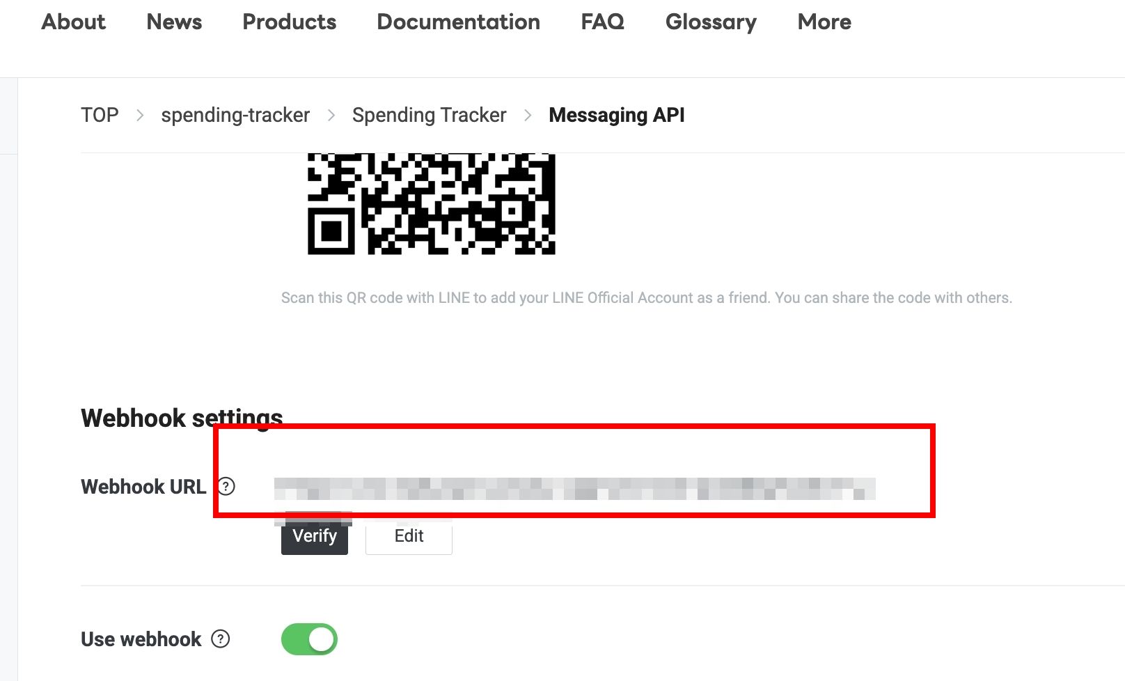

③ Configure the Webhook URL in the LINE Developers Console

③ 於 LINE Developers 控制台設定 Webhook URL

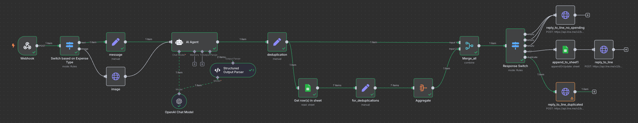

Node Configurations

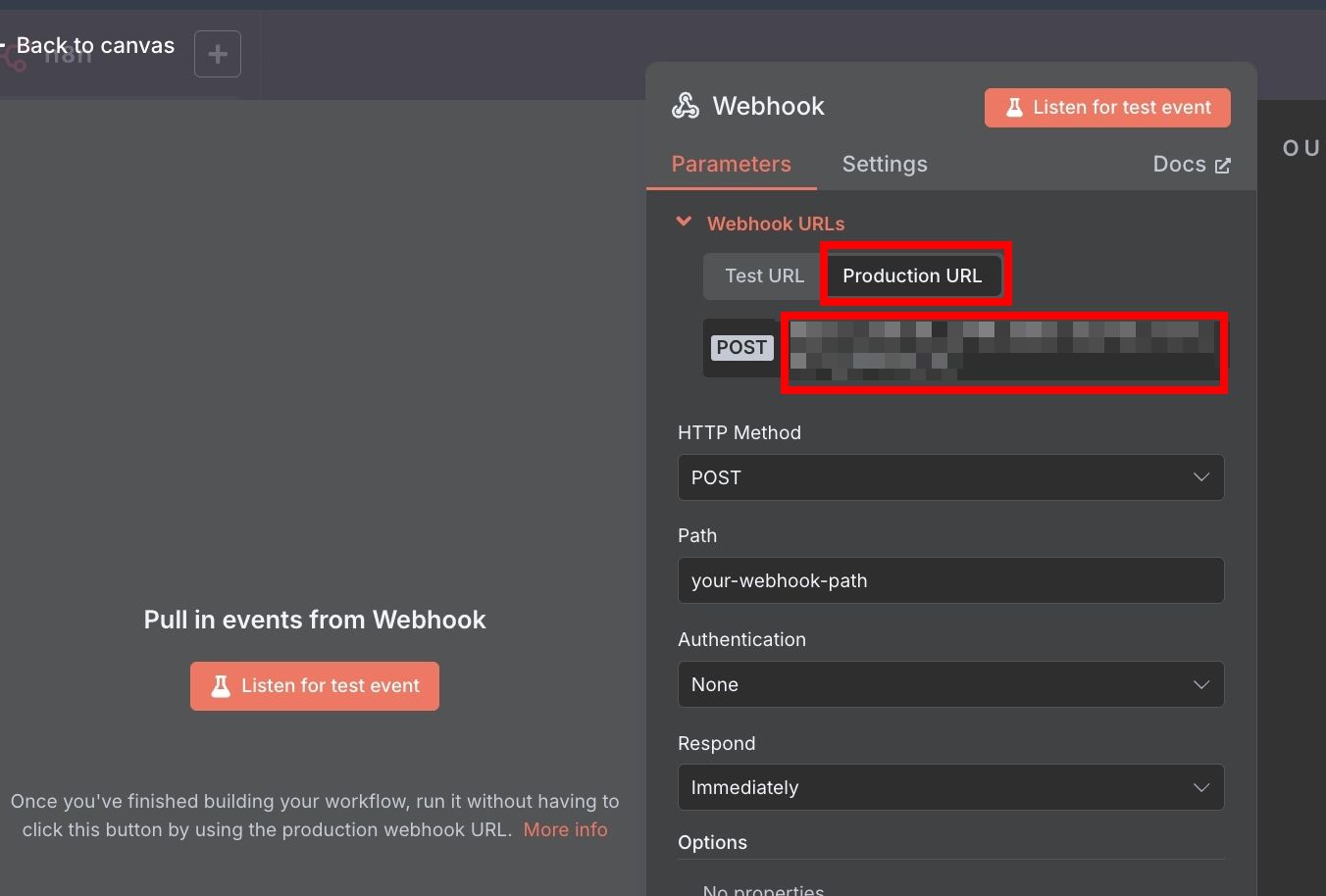

Webhook
Purpose: The URL is used to receive incoming requests from LINE.
Configuration: Paste this URL into the Webhook URL field in your LINE Developers Console.
用途: 要接收 Line 的 URL
設定: 將 URL 放到 Line Webhook URL

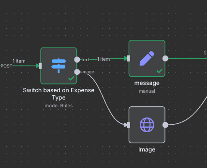

Switch based on Expense Type & Set/Https
Purpose: To distinguish whether the incoming message is text or an image.
Configuration: Use a Switch node to route the flow accordingly.
用途: 區分 text 或 image
設定: switch 分流

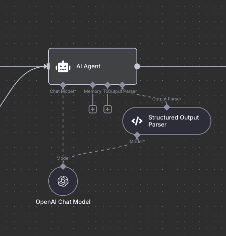

AI Agent
Purpose: To extract and organize the required fields.
Configuration: Chat Model & Structured Output Parser.
用途: 整理出需要的欄位
設定: Chat Model & Structured Output Parser
Create a deduplication field
Purpose: To prevent duplicate entries by creating a unique "for_deduplication" field.
Configuration: Join multiple field names using hyphens (-) as separators.
用途: 確保不會重複寫入,先創建一個"去重使用"欄位
設定: 用 - 連接多個欄位

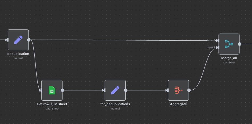

Aggregrate & Merge_all
Purpose: To prevent duplicate entries in the data table.
Configuration: Read the Google sheet, extract the existing "for_deduplication" column into a dedupeList, and compare it against the newly generated "for_deduplication" value from the previous step.
用途: 防止重複寫入資料表
設定:讀取雲端表,將原本的"去重使用欄位"整理成dedupeList,與前一步整理好的"去重使用"欄位做比對

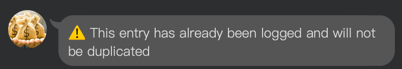

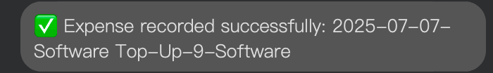

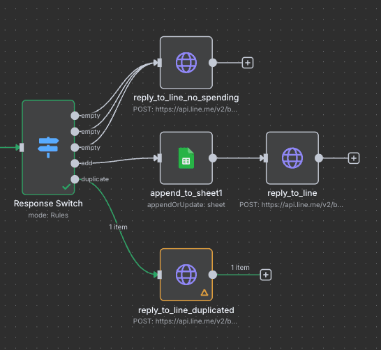

Response Switch
Purpose: To route data and send appropriate replies based on the content.
Configuration: Use the replyToken to respond after branching logic. Depending on the result, either write to the data table or return a message:
  1. ✅ Expense recorded successfully: <for_deduplication>
  2. Irrelevant details or images will not be logged.
  3. ⚠️ This entry has already been logged and will not be duplicated.
用途: 資料分流,回應訊息
設定:使用 replyToken ,資料分流後,寫入資料表或回應訊息
  1. ✅ 記帳成功 : <去重使用欄位>
  2. 不相關明細或圖片,不會計入
  3. ⚠️ 此筆資料已記錄過,不會重複記帳
