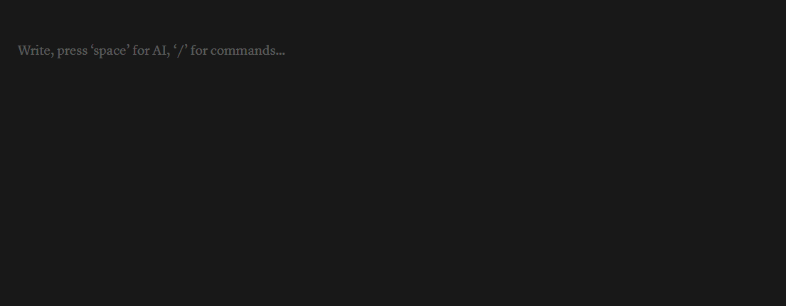

Manual Refreshing
Embed the production URL from the Webhook Trigger inside a "toggle list" or "toggle heading" inside Notion, then expand the heading to refresh, like so:
