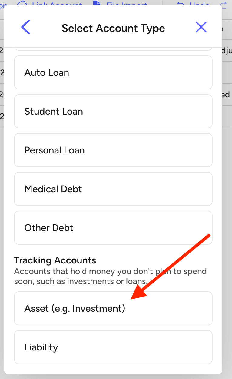

  1. If you don't already have an account to track your property, create a new Unbudgeted tracking asset.

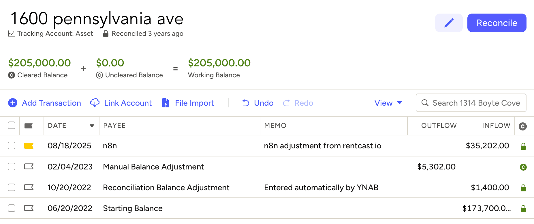

Set the veriables in the 'Set Fields' node (Or setup subworkflow if you have multiple properties).
Variable Explination Example
rentcast_api api key for rentcast
ynab_api apk key for ynab
address Exact address. Its recomended to look it up in rentcast first since they use non standard values like 'srt' , 'ave', ect... 1600 Pennsylvania Ave NW, Washington, DC 20500
propertyType one of 'Single Family', 'Condo', 'Apartment', see api docs for all options Single Family
bedrooms Number of bedrooms (whole number) 3
bathrooms Number of bathrooms, while fractions (2.5) are probably supported, they haven't been tested 2
squareFootage Total square feet 1500
ynab_budget Budget ID (derive from URL) xxxx
ynab_account Account ID (derive from URL ) yyyy
